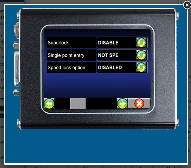

a dá se to diagnostikou zapnout/vypnout (single point entry).

Ano to neni problem vypnout a zapnout
