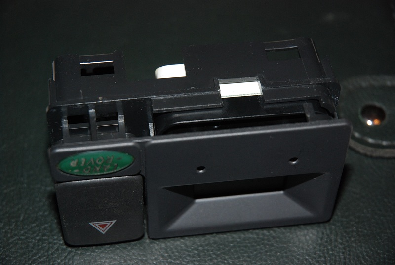

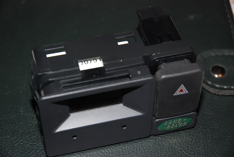

Colonel
Příspěvky: 430
#10 Příspěvek od Colonel » 20 pro 2008 17:17
Tak uz se mi to za pomoci rady z netu a dvou starejch kreditek povedlo vyndat :) Bez nejakyho rozdelavani veci okolo. Pridavam jeste fotky vyndanych hodin, kde je videt, kde jsou ty zobacky, co to drzi.
To move the clock forward use at leat three cards - 1 on the right of the clock 1 on the left of the door locking switch and 1 at the top or bottom.Make sure you hear the click of the plastic releasing the clock and as you are doing this push the clcok from the rear of it.
(After a good few minute's I realised the clock and door locking switch come out together.)
I knew those point collecting card's would come in handy for something !
When it is out turn it upside down and you will see the rear of a small plastic twist type bulb. Turn it a little with a flat screw driver and it will drop out.
