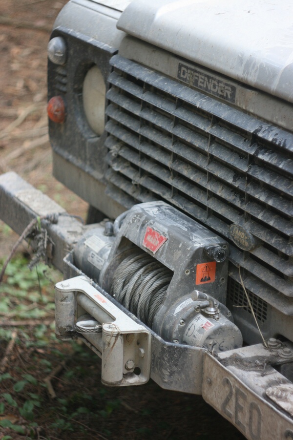

WARN :twisted: :!: :arrow:
(195.92 KiB) Staženo 2545 x
