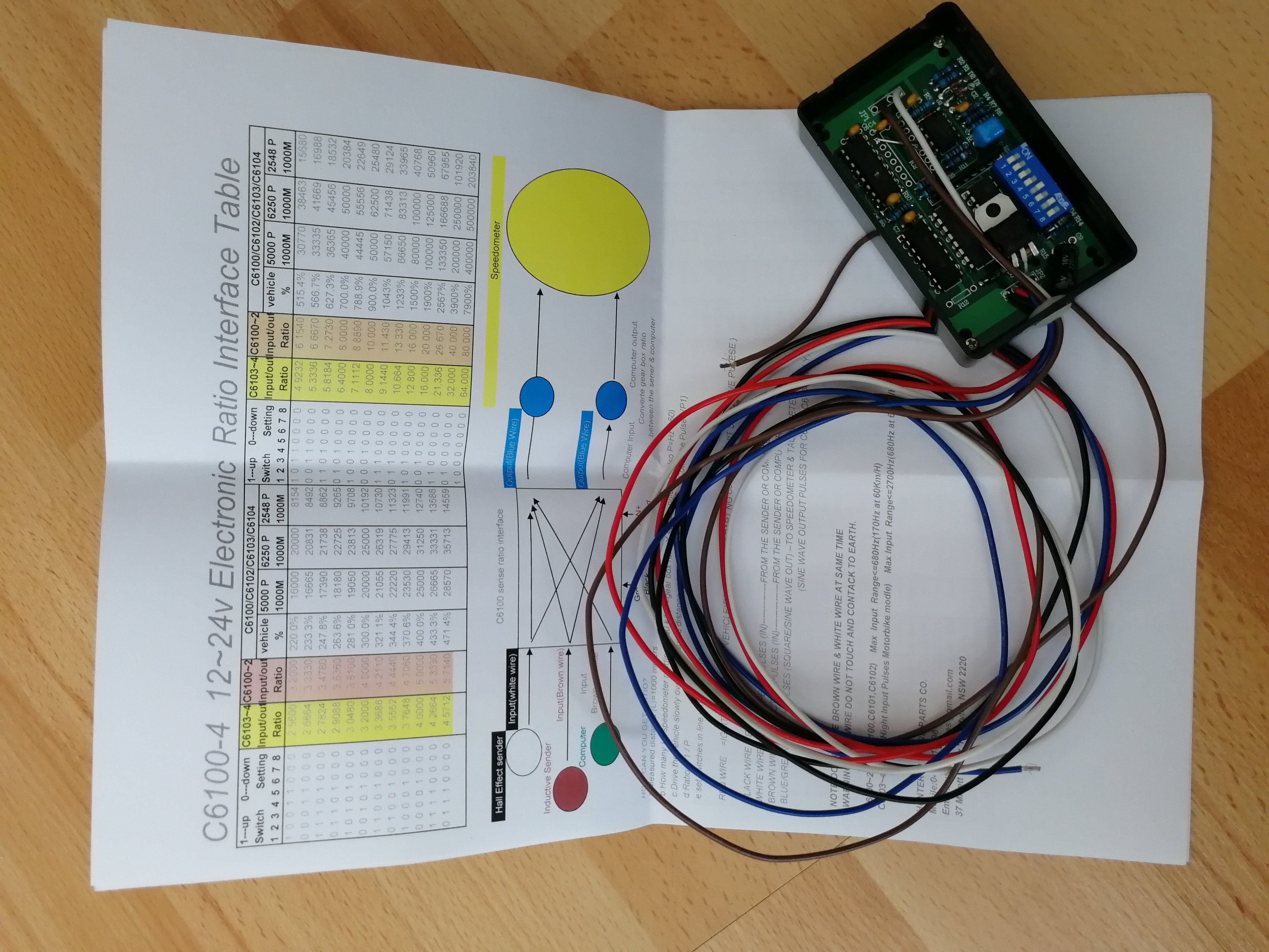

Prosel jsem par postu. K C6100 me zaujalo tohle:
Just looked, it was the Pink with Green tracer that I cut, and joined the C6100 to. This is at the instrument cluster, plug C0230 pin 16.
I found the easiest way was to remove the instrument surround plastic cowl, and fish the two C6100 wires up And join in near the C0230 plug. C6100 brown wire to the Pink/Green from the ECU and C6100 Blue/Green to the Pink/Green going to the instrument plug C0230.
I have used the following switch settings;
01011010 for 235/85R16

Re: Prekalibrovanie tacho na Disco 2
Krabičku jsem minulý týden nainstaloval a můžu potvrdit, že funguje. Nastavení je dostatečně jemné, aby uspokojilo snad každého. Udělám návod kde budou i fotky.
