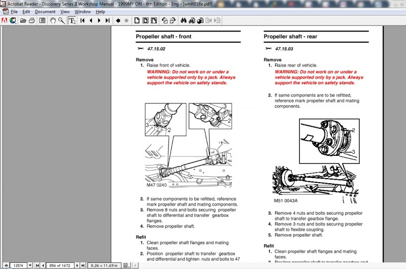

NOTE !!!. IT IS MOST IMPORTANT AND STRONGLY RECOMMENDED !!! THAT YOU IN SOME WAY MARK THE PROP SHAFT IN RELATION TO THE FLANGES ON THE DIFFERENTIALS AND THE TRANSFER CASE SO YOU CAN REFIT THE PROP SHAFT BACK IN IT'S ORIGINAL POSITION, THIS WILL HOPEFULLY ELIMINATE ANY POSSIBILITY OF DRIVE TRAIN VIBRATION ON RE-ASSEMBLY.petmic píše:a aka je povodna poloha ked menis kardan za fungl novy ktory nikdy na aute nebol?mipr píše:petmic tu sa bavime o najdeni povednej polohy kardanu, nie o vyvazovani... ci?

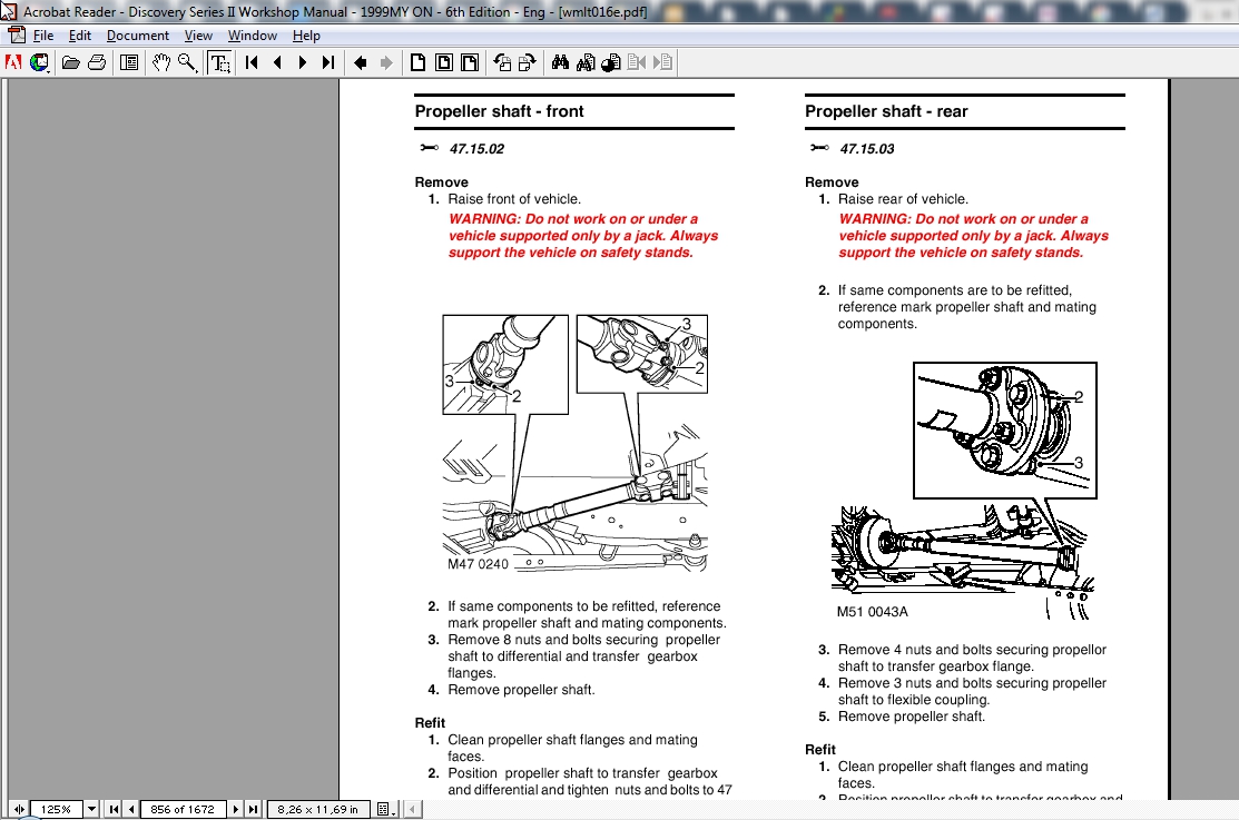

RAVE hlasi:
2. If same components to be refitted, reference
mark propeller shaft and mating components.
